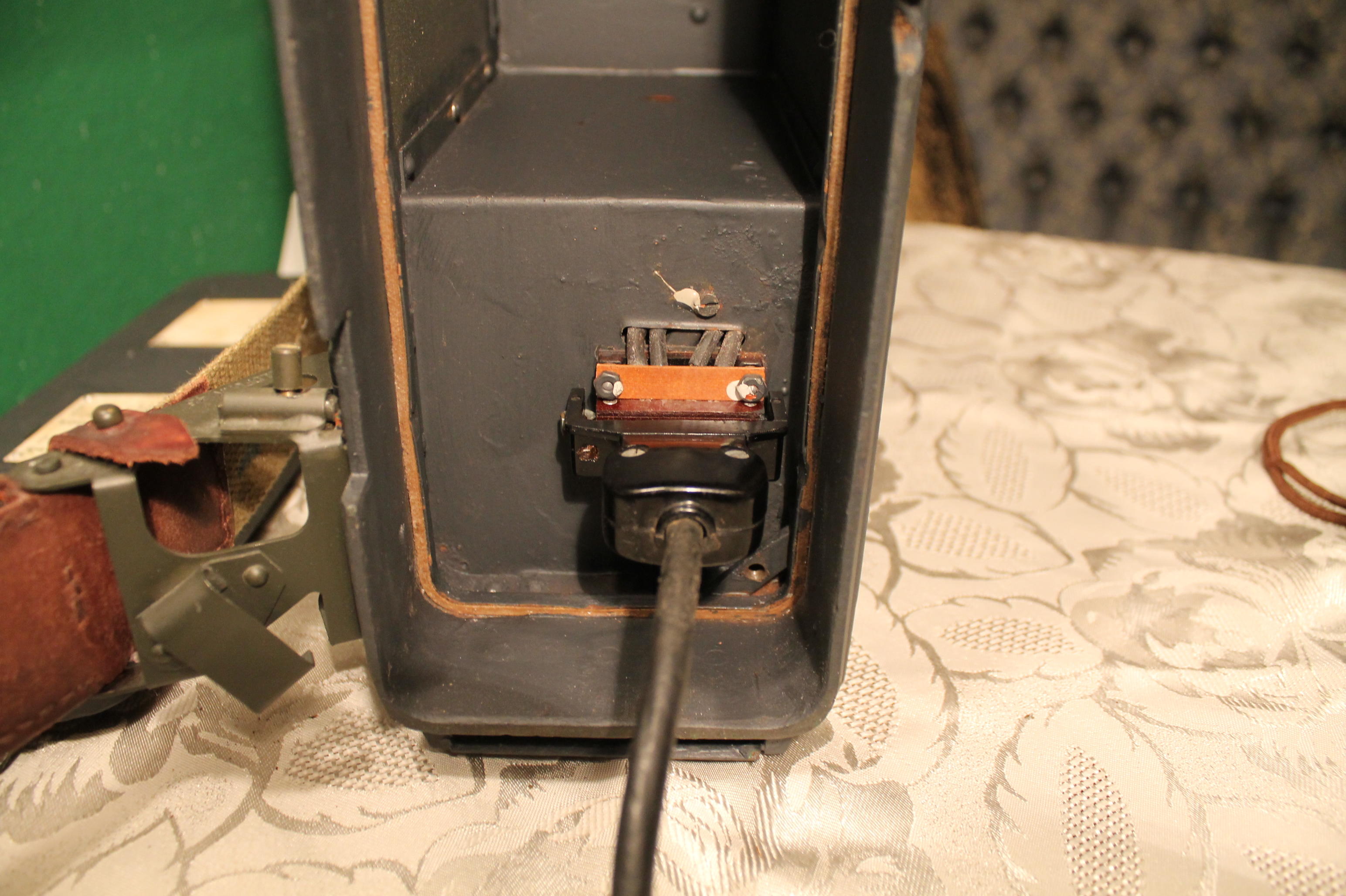

In the midst of shopping for christmas gifts, I actually stumbeled across a original Feldfu. Prüfkabel, or test cable, as shown earlier in this thread by Funksammler.
It's the first cable like this, that I have ever seen for sale.
Needless to say, I just had to have it. I have just tested it between the radio and the casing, and it works like a dream.

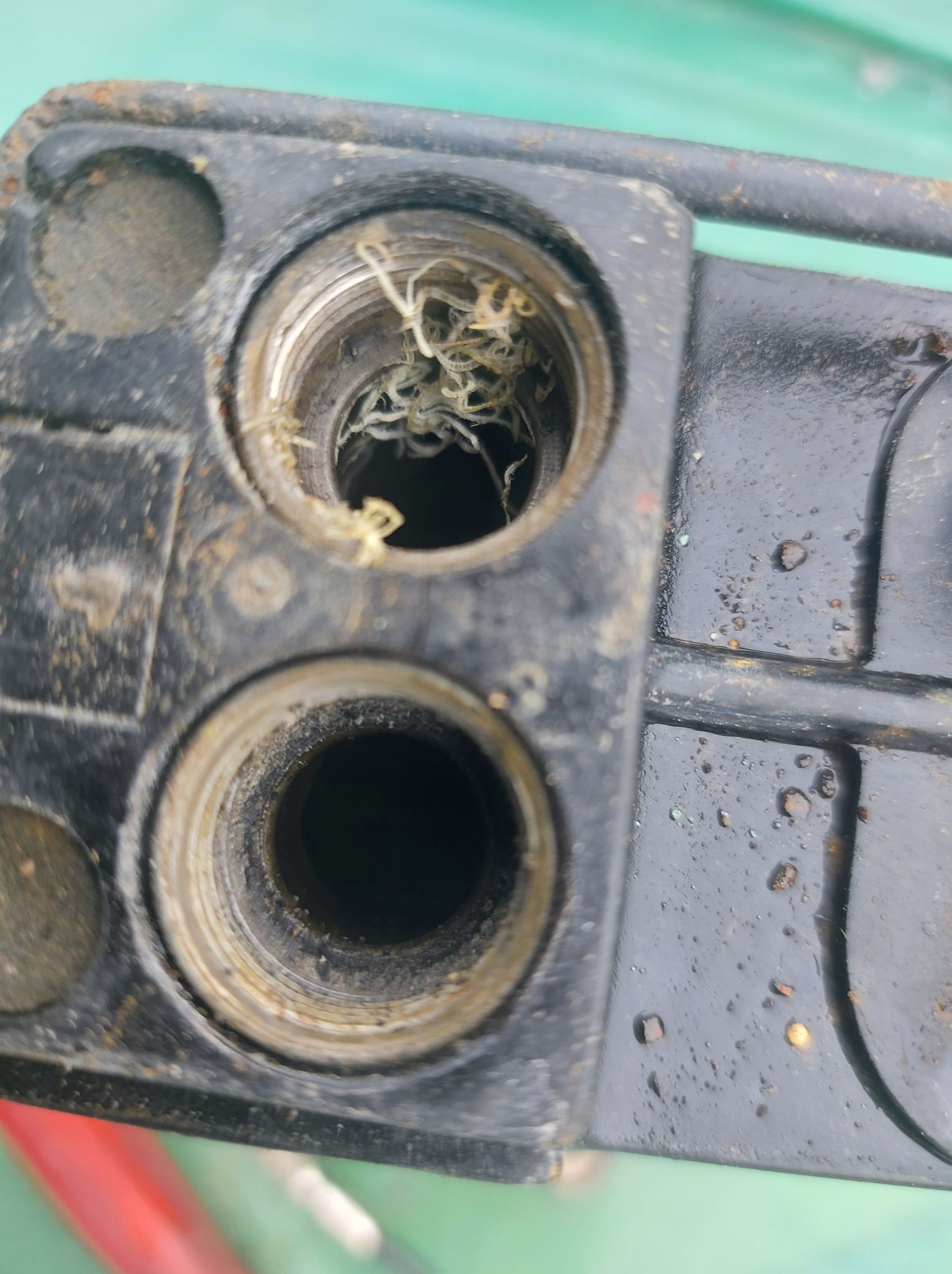

A lot of rust, dirt and grime. The connection nuts were frozen, but by scraping a bit on the posts, I got a initial reading of 0,02 Volts at the posts.
So I took the battery outside, gave it a bath in oxalic acid and tried to clean it a little bit.
Original paint appeared, dark gray. And part of the stencilled legend actually became visible.
I was able to loosen the nuts at the posts. ( I have carefully taken off the red plastic on the positive post, and will glue it together and back on the nut again.
I also got the filler plugs out. Look atr this. It looks like that there is some life form growing just under the filling plug at the negative side. I was able to take it out, it was not growing further down in the battery.

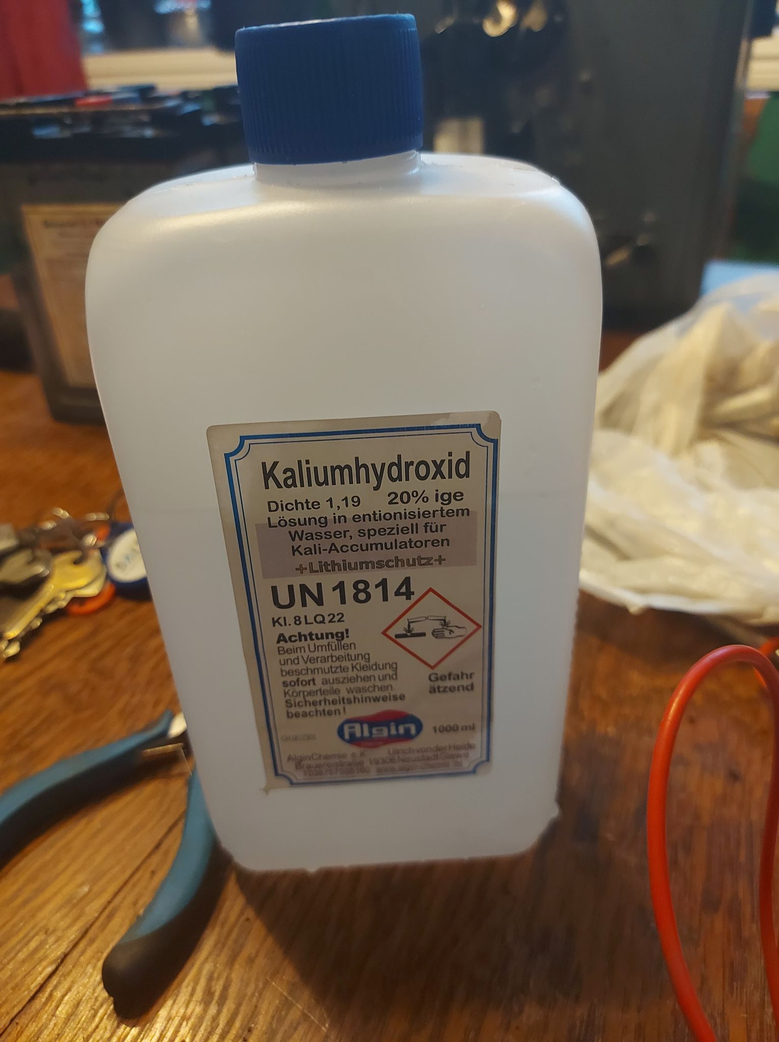

I will flush the battery and fill in som new Kalilauge electrolyte, and put it on a charging cycle. If I am lucky, I will have a third working battery for my feldfu radios. It only need some cosmetic restoration.

Some flushing pictures. I filled som more Kaliumhydroxyd in the battery and shook it, to loosen som grime inside. Here's a picture of the first (of many) flushings. The contents of the battery was pitch black.
Almost finished on this picture. Notice the empty bottle in the background - I spent a Liter of Kalilauge, just to flush out and clean the battery inside:
And Here I am finished with the internal cleaning.
The battery is topped up with fresh Kalilauge.
I just wanted to do a measuring, before I started to try and charge it. 0,45 Volts.
Gentlemen, I believe we have a live one:
I bought 10 Litres of Kaliumhydroxid a few years ago from ebay. Should last a whole lifetime for me, on just 3 Batteries for the Feldfunksprecher :)
