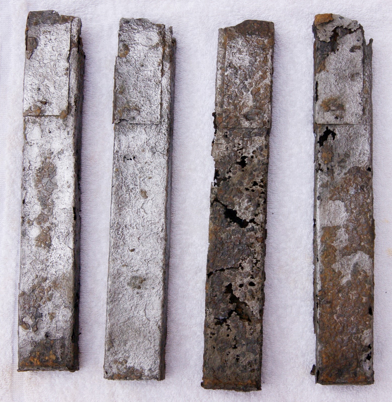

Sten mags freshly out the ground....

Same mags, a couple of days later.....
